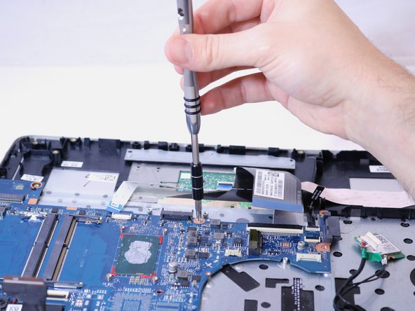

  15. hp pavilion 15-cc023cl Motherboard Replacement: crwdns2935265:015crwdnd2935265:01crwdnd2935265:02crwdne2935265:0 hp pavilion 15-cc023cl Motherboard Replacement: crwdns2935265:015crwdnd2935265:02crwdnd2935265:02crwdne2935265:0
    • Use a PH1 screwdriver to unscrew six 3 mm Phillips head screws on the motherboard.
