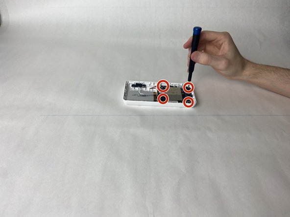

  6. eufy Security SpaceView Monitor Charging Port Replacement, Motherboard: crwdns2935265:06crwdnd2935265:01crwdnd2935265:02crwdne2935265:0 eufy Security SpaceView Monitor Charging Port Replacement, Motherboard: crwdns2935265:06crwdnd2935265:02crwdnd2935265:02crwdne2935265:0
    • Using a Phillips #00 screwdriver, unscrew the 4 retaining screws in each corner of the motherboard.

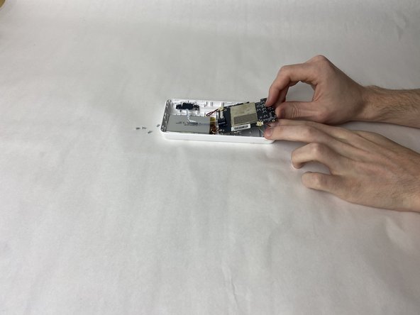

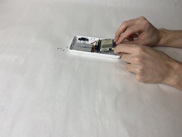

  7. eufy Security SpaceView Monitor Charging Port Replacement: crwdns2935265:07crwdnd2935265:01crwdnd2935265:03crwdne2935265:0 eufy Security SpaceView Monitor Charging Port Replacement: crwdns2935265:07crwdnd2935265:02crwdnd2935265:03crwdne2935265:0 eufy Security SpaceView Monitor Charging Port Replacement: crwdns2935265:07crwdnd2935265:03crwdnd2935265:03crwdne2935265:0
    • Starting with either red/black wired connector on, gently pull it from its receptor and set it aside.
    • Pull the white ribbon connector from the motherboard, on the side closest to the battery.
    • Lift the motherboard and disconnect the antenna connector from its port.
    • The motherboard is free from the housing and can be replaced.
