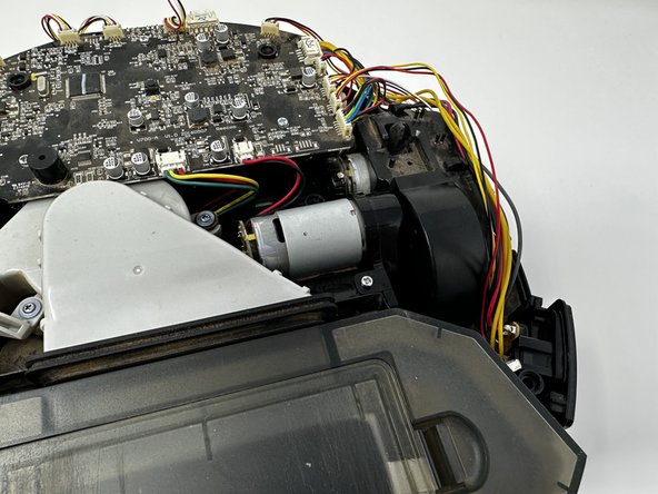

  7. eufy RoboVac 11 Wheel and Wheel Motor Replacement, Wheel and Wheel Motor: crwdns2935265:07crwdnd2935265:01crwdnd2935265:03crwdne2935265:0 eufy RoboVac 11 Wheel and Wheel Motor Replacement, Wheel and Wheel Motor: crwdns2935265:07crwdnd2935265:02crwdnd2935265:03crwdne2935265:0 eufy RoboVac 11 Wheel and Wheel Motor Replacement, Wheel and Wheel Motor: crwdns2935265:07crwdnd2935265:03crwdnd2935265:03crwdne2935265:0
    • Remove the wheels.
    • The removal of the two wheels is the same on both sides, but on the left side there is a motor in the way of the wheels.
    • Remove the single 10 mm screw with the Phillips #1 screwdriver and then pull upwards to remove the piece preventing removal.

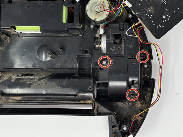

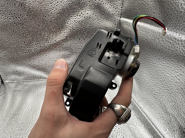

  8. eufy RoboVac 11 Wheel and Wheel Motor Replacement: crwdns2935265:08crwdnd2935265:01crwdnd2935265:03crwdne2935265:0 eufy RoboVac 11 Wheel and Wheel Motor Replacement: crwdns2935265:08crwdnd2935265:02crwdnd2935265:03crwdne2935265:0 eufy RoboVac 11 Wheel and Wheel Motor Replacement: crwdns2935265:08crwdnd2935265:03crwdnd2935265:03crwdne2935265:0
    • Remove the three 10 mm screws with the Phillips #1 screwdriver.
    • Remove motors.
    • The process for removing the left and right motors is the same.
