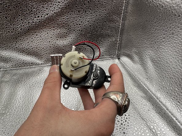

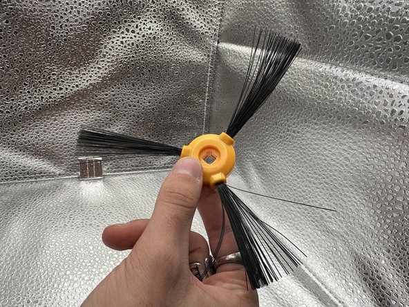

  6. eufy RoboVac 11 Side Brush Replacement, Side Brush: crwdns2935265:06crwdnd2935265:01crwdnd2935265:03crwdne2935265:0 eufy RoboVac 11 Side Brush Replacement, Side Brush: crwdns2935265:06crwdnd2935265:02crwdnd2935265:03crwdne2935265:0 eufy RoboVac 11 Side Brush Replacement, Side Brush: crwdns2935265:06crwdnd2935265:03crwdnd2935265:03crwdne2935265:0
    • Remove the 10 mm side brush motor screws with the Phillips #1 screwdriver.
    • Remove the side brushes.
    • Remove the side brush motors.
