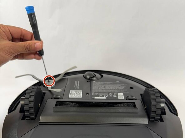

    • Turn the eufy L60 vacuum upside down.
    • Use a Phillips #2 screwdriver to remove the 5.8 mm screw from the grey spinning brush on the bottom.
  2. eufy L60 Side Brush Replacement: crwdns2935265:02crwdnd2935265:01crwdnd2935265:01crwdne2935265:0
    • Give the brush a slight tug to pop it off.
