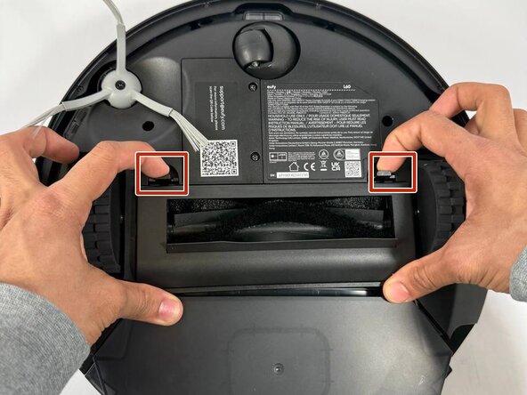

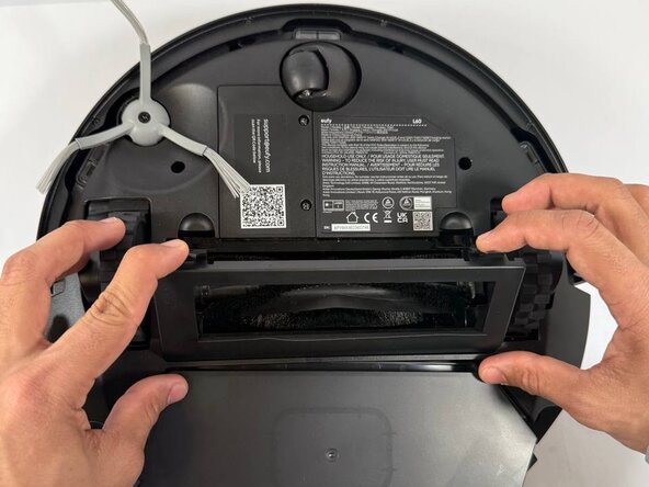

    • Turn the eufy L60 vacuum upside down.
    • Push down on the two tabs by the brush to pop the plastic cover off.

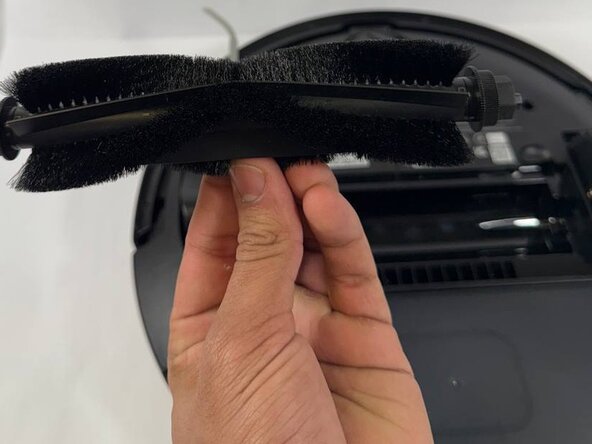

    • Pull the brush slightly to the right to remove it.
