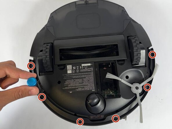

    • Flip over the eufy L60 vacuum and turn off the power.
    • Use the Phillips #2 screwdriver to remove the six 2.4 mm screws positioned along the bumper.
  2. eufy L60 Bumper Replacement: crwdns2935265:02crwdnd2935265:01crwdnd2935265:01crwdne2935265:0
    • Lift the bumper slightly and jiggle it free.
