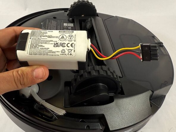

    • Flip over the eufy L60 vacuum.
  2. eufy L60 Battery Replacement: crwdns2935265:02crwdnd2935265:01crwdnd2935265:01crwdne2935265:0
    • Remove the 4.1 mm screws using a Phillips #1 screwdriver.
  3. eufy L60 Battery Replacement: crwdns2935265:03crwdnd2935265:01crwdnd2935265:01crwdne2935265:0
    • Lift up the tab on the battery compartment.
  4. eufy L60 Battery Replacement: crwdns2935265:04crwdnd2935265:01crwdnd2935265:02crwdne2935265:0 eufy L60 Battery Replacement: crwdns2935265:04crwdnd2935265:02crwdnd2935265:02crwdne2935265:0
    • Lift the battery out of the compartment using your fingers.
    • Unplug the battery from the motherboard.
