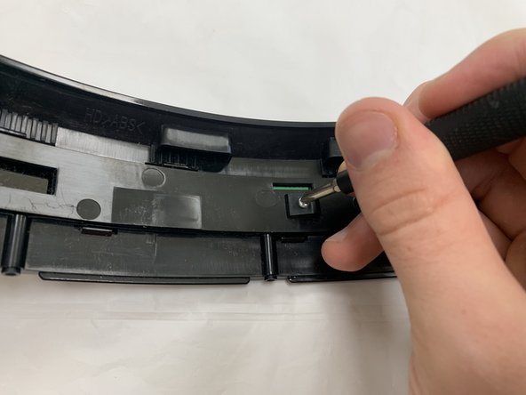

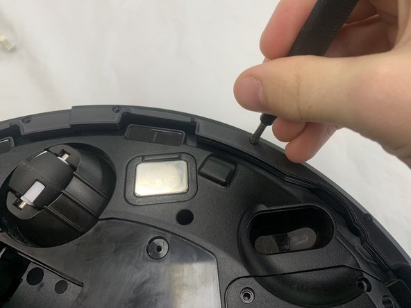

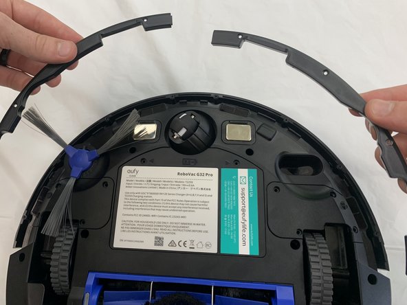

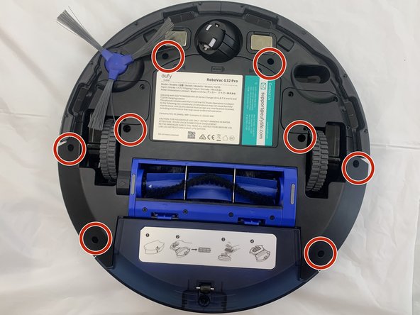

  14. eufy Clean RoboVac G32 Pro Motherboard Replacement, Bump Sensor: crwdns2935265:014crwdnd2935265:01crwdnd2935265:03crwdne2935265:0 eufy Clean RoboVac G32 Pro Motherboard Replacement, Bump Sensor: crwdns2935265:014crwdnd2935265:02crwdnd2935265:03crwdne2935265:0 eufy Clean RoboVac G32 Pro Motherboard Replacement, Bump Sensor: crwdns2935265:014crwdnd2935265:03crwdnd2935265:03crwdne2935265:0
    • Orient the device so the underside is facing up.
    • Remove the eight 9.3 mm screws securing the bumper brackets using a Phillips #1 screwdriver.
    • Remove the bumper brackets.

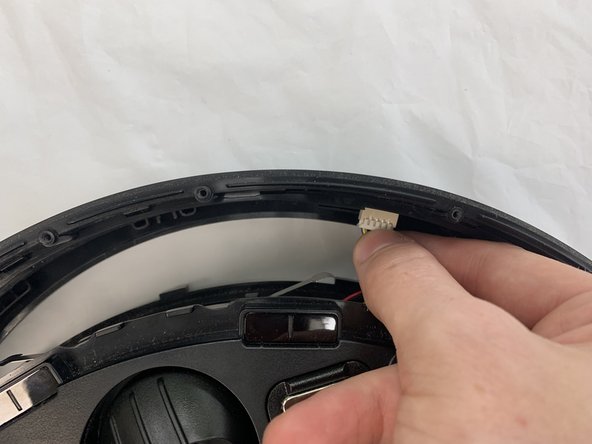

  15. eufy Clean RoboVac G32 Pro Motherboard Replacement: crwdns2935265:015crwdnd2935265:01crwdnd2935265:02crwdne2935265:0 eufy Clean RoboVac G32 Pro Motherboard Replacement: crwdns2935265:015crwdnd2935265:02crwdnd2935265:02crwdne2935265:0
    • Lift the bumper off of the device gently.
    • Use your fingers to disconnect the 8 pin connector.

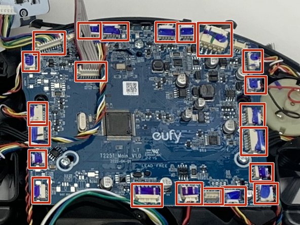

  18. eufy Clean RoboVac G32 Pro Motherboard Replacement, Motherboard: crwdns2935265:018crwdnd2935265:01crwdnd2935265:02crwdne2935265:0 eufy Clean RoboVac G32 Pro Motherboard Replacement, Motherboard: crwdns2935265:018crwdnd2935265:02crwdnd2935265:02crwdne2935265:0
    • Remove the eight 14 mm screws with a Phillips #1 screwdriver.
  19. eufy Clean RoboVac G32 Pro Motherboard Replacement: crwdns2935265:019crwdnd2935265:01crwdnd2935265:01crwdne2935265:0
    • Use your hands to separate the two halves by lifting the cover from the end that has the brush, as the cover is still connected.

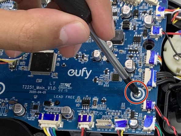

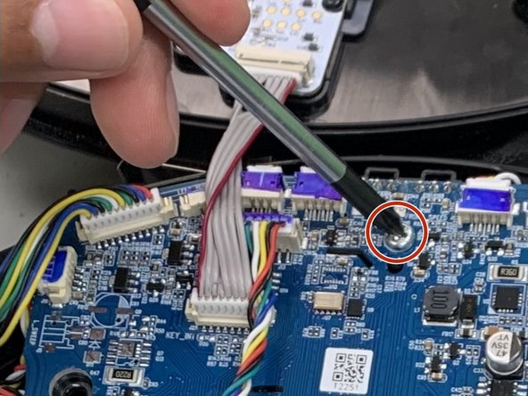

  20. eufy Clean RoboVac G32 Pro Motherboard Replacement: crwdns2935265:020crwdnd2935265:01crwdnd2935265:03crwdne2935265:0 eufy Clean RoboVac G32 Pro Motherboard Replacement: crwdns2935265:020crwdnd2935265:02crwdnd2935265:03crwdne2935265:0 eufy Clean RoboVac G32 Pro Motherboard Replacement: crwdns2935265:020crwdnd2935265:03crwdnd2935265:03crwdne2935265:0
    • Remove the three 9.7 mm screws securing the motherboard with a Phillips #0 screwdriver.
  21. eufy Clean RoboVac G32 Pro Motherboard Replacement: crwdns2935265:021crwdnd2935265:01crwdnd2935265:02crwdne2935265:0 eufy Clean RoboVac G32 Pro Motherboard Replacement: crwdns2935265:021crwdnd2935265:02crwdnd2935265:02crwdne2935265:0
    • Disconnect all connectors attached to motherboard.
    • Using your fingers, pull the connectors away from their ports by the plastic bit of the wire.
    • Pulling from the wires themselves could lead to the wire(s) loosening from the connector.
    • Remove the motherboard.
