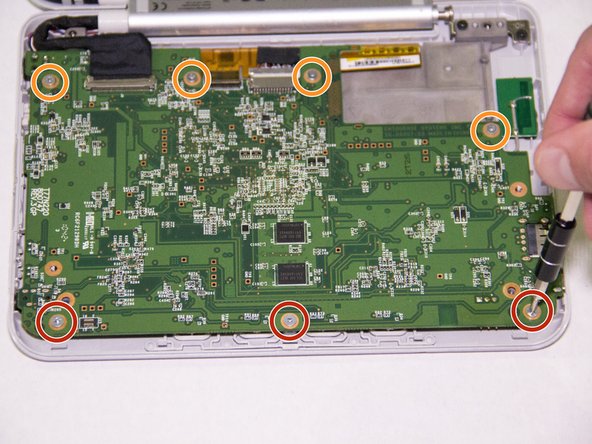

    • Locate the side of the device containing the motherboard.
    • Using your J0 Phillips head screwdriver, remove the three 5mm screws from the bottom of the motherboard.
    • Using your J0 Phillips head screwdriver, remove the four 3mm screws from the top of the motherboard.
  7. enTourage Pocket eDGe Motherboard Replacement: crwdns2935265:07crwdnd2935265:01crwdnd2935265:01crwdne2935265:0
    • Using the plastic spudger, carefully pry the bottom of the motherboard up and away from the casing.

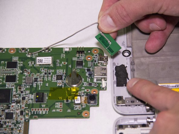

  9. enTourage Pocket eDGe Motherboard Replacement: crwdns2935265:09crwdnd2935265:01crwdnd2935265:01crwdne2935265:0
    • Lift the outer edge of the motherboard up. Carefully disconnect the 3 connections on bottom of the motherboard by pulling gently.
  10. enTourage Pocket eDGe Motherboard Replacement: crwdns2935265:010crwdnd2935265:01crwdnd2935265:02crwdne2935265:0 enTourage Pocket eDGe Motherboard Replacement: crwdns2935265:010crwdnd2935265:02crwdnd2935265:02crwdne2935265:0
    • The motherboard is now connected in only one place on the edge of the device. Being careful of this, flip the motherboard outside of the device, leaving it connected to the foam padding inside of the device.
    • Carefully pry the small rectangle apart from the thin strip of foam.
    • If the foam is still intact you may leave the foam in order to reattach the new motherboard.
