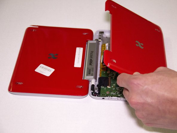

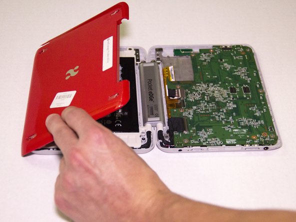

    • Using the plastic opening tool, lift the back plate from both sides of your device and remove them.

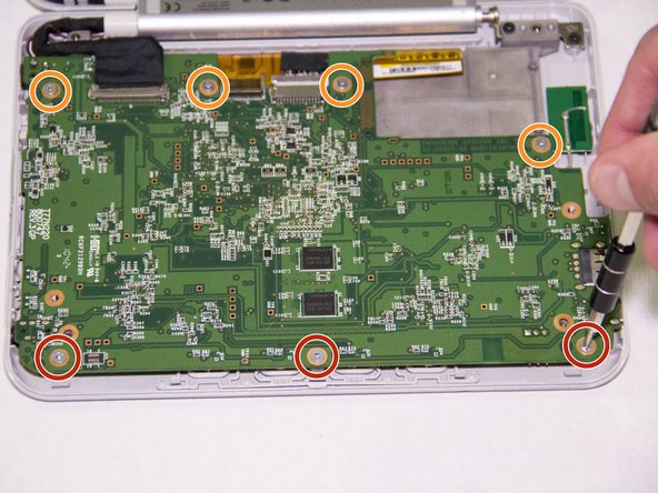

    • Locate the side of the device containing the motherboard.
    • Using your J0 Phillips head screwdriver, remove the three 5mm screws from the bottom of the motherboard.
    • Using your J0 Phillips head screwdriver, remove the four 3mm screws from the top of the motherboard.

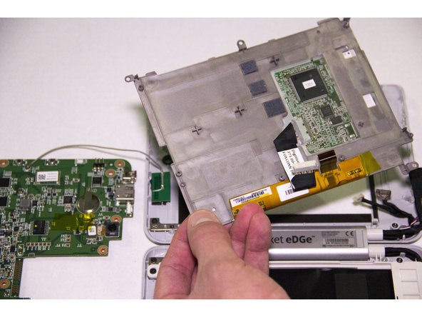

    • Using your J0 Phillips head screwdriver, remove the one 5 mm screw holding the gray plastic e-reader screen backing into place.
  12. enTourage Pocket eDGe E-Reader Screen Replacement: crwdns2935265:012crwdnd2935265:01crwdnd2935265:02crwdne2935265:0 enTourage Pocket eDGe E-Reader Screen Replacement: crwdns2935265:012crwdnd2935265:02crwdnd2935265:02crwdne2935265:0
    • Carefully pry up the gray plastic e-reader screen using your finger and remove from the device.
