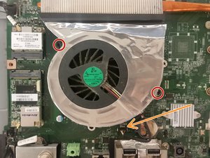

Remove the two Torx/Flathead screws securing the fan.
Pull up on the fan connector to remove it.
Lift the fan to remove it.
