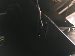

The left side supporting wire is pretty easy to remove.
Pushing the clip down will allow you to slide it out of the door, releasing the cable.
This cable is spring loaded, and will retract upwards into the dash.
