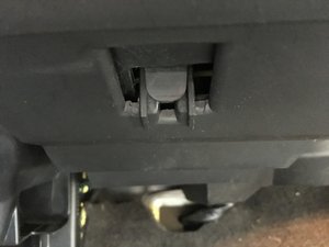

Remove the clips on each side, this can be done by pushing the exposed tab forward.
The kick panel should now fall down.
Don't pull the panel out just yet, there's still a courtesy light that is mounted on the panel and connected with a wire.
