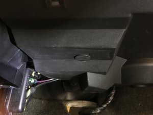

Use a plastic fastener removal tool to pop out the plastic fastener. This fastener was not designed to be easily removable, but the tool helps a lot.
If you're careful, you can remove the fastener without damaging it. Try to fold all of the "ridges" back before re-inserting it. If you plan on removing the kick panel again, you may want to invest in a fastener that's easier to remove.
