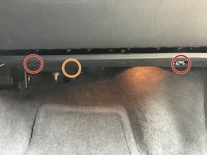

To access the hinges for the glove compartment door, the passenger side kick panel must first be removed.
There are two clips (red),and a plastic fastener (orange, located further back) holding this panel to the dash. You'll put less bending stress on the panel if you remove the plastic fastener first.
