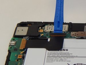

Use a plastic opening tool to lift the black flap on the ZIF connector located in the top left corner of the device.
Once the connector is unlocked, pull the ribbon cable out with tweezers.
This cable does not need to be completely removed, only one side is enough to allow the battery to be taken out.
