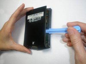

Use a plastic opening tool to pry the back case from the WorkPad.
If the rear cover is not coming off very easily, you probably need to reheat the case in order to sufficiently melt the glue.
