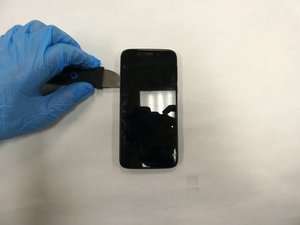

Use a heat gun, hairdryer, or iOpener to weaken the adhesive around the front screen. If you're using the iOpener, please review the instructions for proper use.
Use the plastic opening tools or picks to create an gap between the screen and the rest of the device.
Do not use the Jimmy or metal spudger on fragile components, as these tools may end up causing more damage than good.
