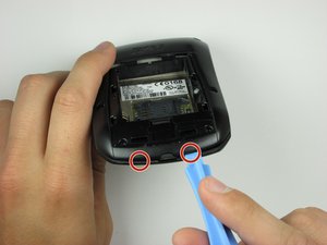

Use the plastic opening tool to apply pressure on the two clips that are located at the bottom of the phone.
