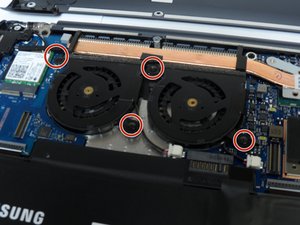

Using a Phillips head screwdriver, unscrew four 4.55 mm Phillips #000 screws that bind the fans.
