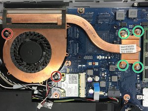

Use the Phillips #0 screwdriver to remove the two 3.0mm screws.
Loosen the four spring loaded screws using the Phillips #0 screwdriver. These do NOT come out.
