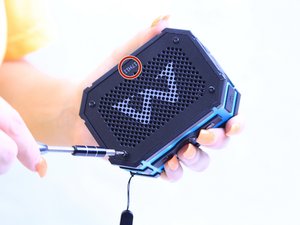

Remove four Hex 10 mm screws from the outer speaker cover displaying the speaker's serial number indicated by the red circle.
Carefully insert the spudger tool into one of the holes in the cover to pry open the outer cover of the speaker.
