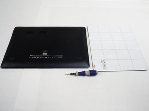

Turn the laptop upside down so that the underside of the laptop is facing you.
Use a Phillips #000 screwdriver to unscrew the 4.3 mm screws located on the edges and corners of the laptop.
