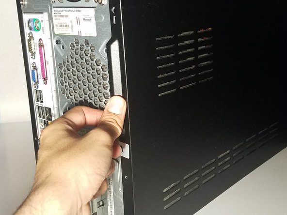

    3. eMachine T5234 RAM Disks Replacement: crwdns2935265:03crwdnd2935265:01crwdnd2935265:02crwdne2935265:0 eMachine T5234 RAM Disks Replacement: crwdns2935265:03crwdnd2935265:02crwdnd2935265:02crwdne2935265:0
      • Using your hands, dislodge the casing and pull the case panel towards you until the panel comes off.

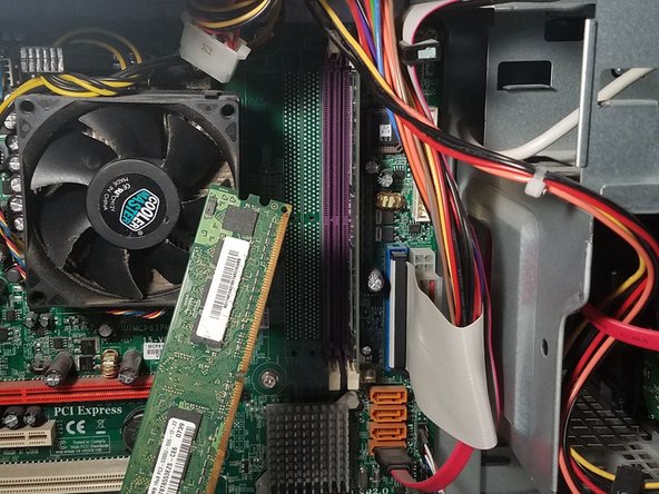

    4. eMachine T5234 RAM Disks Replacement, Locate the RAM Disk Slots: crwdns2935265:04crwdnd2935265:01crwdnd2935265:03crwdne2935265:0 eMachine T5234 RAM Disks Replacement, Locate the RAM Disk Slots: crwdns2935265:04crwdnd2935265:02crwdnd2935265:03crwdne2935265:0 eMachine T5234 RAM Disks Replacement, Locate the RAM Disk Slots: crwdns2935265:04crwdnd2935265:03crwdnd2935265:03crwdne2935265:0
      • With the case panel open, locate the two RAM disk slots on the right side of the motherboard.
      • Do not touch the motherboard with your hands. The oil on your skin can damage or destroy the hardware modules.

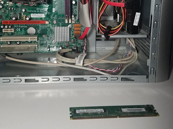

    8. eMachine T5234 RAM Disks Replacement, Installing the RAM Disks: crwdns2935265:08crwdnd2935265:01crwdnd2935265:01crwdne2935265:0
      • Remove your new RAM disks from their casing.
      • Hold the RAM disk along the sides and avoid skin contact with any of the gold components.

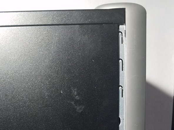

    12. eMachine T5234 RAM Disks Replacement, Reassembly: crwdns2935265:012crwdnd2935265:01crwdnd2935265:03crwdne2935265:0 eMachine T5234 RAM Disks Replacement, Reassembly: crwdns2935265:012crwdnd2935265:02crwdnd2935265:03crwdne2935265:0 eMachine T5234 RAM Disks Replacement, Reassembly: crwdns2935265:012crwdnd2935265:03crwdnd2935265:03crwdne2935265:0
      • Use both hands to align the case panel to the case frame.
      • Once in place, push the case panel forward until it secures in place.
