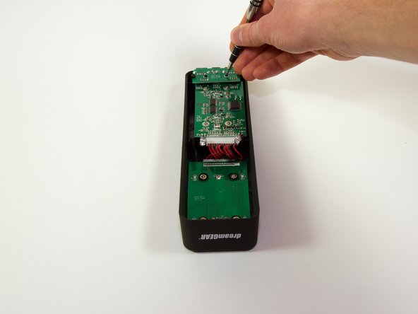

  6. dreamGEAR Quad Dock Pro Power Ribbon Cord Replacement: crwdns2935265:06crwdnd2935265:01crwdnd2935265:02crwdne2935265:0 dreamGEAR Quad Dock Pro Power Ribbon Cord Replacement: crwdns2935265:06crwdnd2935265:02crwdnd2935265:02crwdne2935265:0
    • Use a plastic opening tool or similar tool to gently pry the power ribbon cord out of its port.

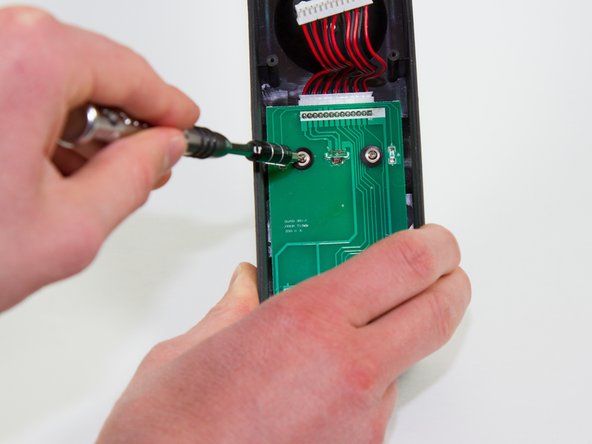

  7. dreamGEAR Quad Dock Pro Power Ribbon Cord Replacement, Power Board: crwdns2935265:07crwdnd2935265:01crwdnd2935265:02crwdne2935265:0 dreamGEAR Quad Dock Pro Power Ribbon Cord Replacement, Power Board: crwdns2935265:07crwdnd2935265:02crwdnd2935265:02crwdne2935265:0
    • Remove the four 1.8 mm PH0 screws that are holding the board in.
    • When you remove these screws, the plastic cups inside the PS Move stations will fall out.

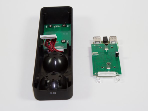

  8. dreamGEAR Quad Dock Pro Power Ribbon Cord Replacement: crwdns2935265:08crwdnd2935265:01crwdnd2935265:01crwdne2935265:0
    • Pick up the board.
    • Pick the board straight up, or you risk damaging the charging ports.
  9. dreamGEAR Quad Dock Pro Power Ribbon Cord Replacement: crwdns2935265:09crwdnd2935265:01crwdnd2935265:01crwdne2935265:0
    • Using a plastic opening tool or a similar tool, gently pry the power ribbon cord out of its port.
