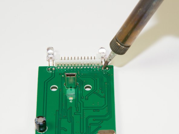

    1. dreamGEAR Quad Dock Pro LEDs Replacement, LEDs: crwdns2935265:07crwdnd2935265:01crwdnd2935265:02crwdne2935265:0 dreamGEAR Quad Dock Pro LEDs Replacement, LEDs: crwdns2935265:07crwdnd2935265:02crwdnd2935265:02crwdne2935265:0
      • Desolder the two points following the instructions included in your soldering kit as you remove the light.
      • FIRE HAZARD! BURN DANGER! Follow all the safety precautions included with your soldering kit.
      • You can follow iFixit's guide to soldering here.
