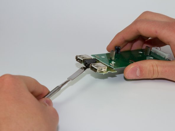

  6. dreamGEAR Quad Dock Pro Electrical Port Replacement: crwdns2935265:06crwdnd2935265:01crwdnd2935265:02crwdne2935265:0 dreamGEAR Quad Dock Pro Electrical Port Replacement: crwdns2935265:06crwdnd2935265:02crwdnd2935265:02crwdne2935265:0
    • Use a plastic opening tool or similar tool to gently pry the power ribbon cord out of its port.

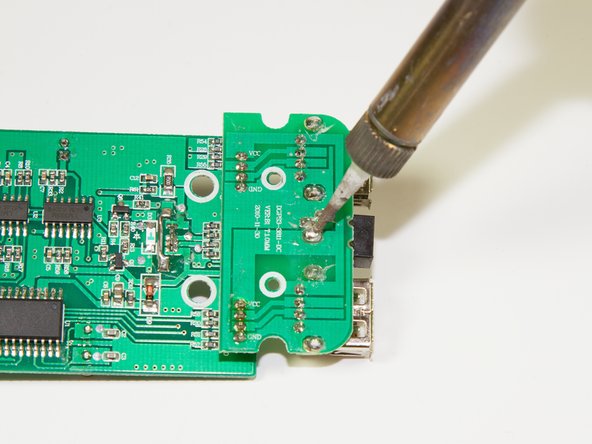

  7. dreamGEAR Quad Dock Pro Electrical Port Replacement, Electrical Port: crwdns2935265:07crwdnd2935265:01crwdnd2935265:03crwdne2935265:0 dreamGEAR Quad Dock Pro Electrical Port Replacement, Electrical Port: crwdns2935265:07crwdnd2935265:02crwdnd2935265:03crwdne2935265:0 dreamGEAR Quad Dock Pro Electrical Port Replacement, Electrical Port: crwdns2935265:07crwdnd2935265:03crwdnd2935265:03crwdne2935265:0
    • Locate the three solder connections for the electrical port.
    • Desolder the connection points following the instructions included with your soldering kit as you remove the port.
    • FIRE HAZARD! BURN DANGER! Follow all the safety precautions included with your soldering kit.
    • It is helpful to use a nylon or metal spudger or tweezers for the removal of this component, pieces of which are very hot.
    • You can follow iFixit's guide to soldering here.
