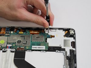

+[* red] Unscrew the two screws securing the white speaker with the screwdriver and the Phillips #0.
