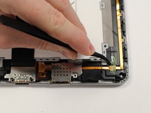

+[* black] Pop open the orange wire tab connected to the SD port.
+[* icon_note] If there is tape covering your tab remove it with the tweezers before you pop open the tab.
