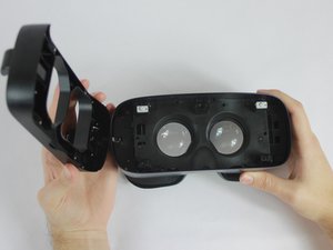

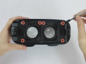

+[* black] After removing the six screws the front phone mount can be lifted up and to the left.
+[* icon_caution] When handling your equipment be careful not to strain the wire harness located on the left side of the headset.
