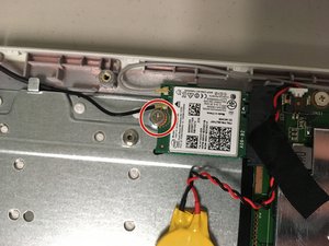

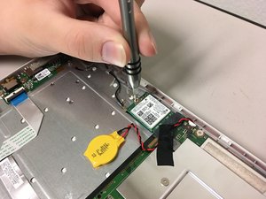

+[* red] After the two wires are disconnected from the Wi-Fi card, unscrew the one 4mm screw keeping the card in place.
