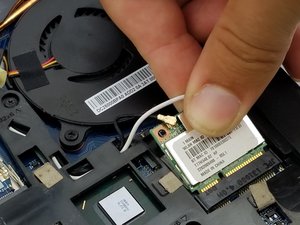

+[* black] Using the Phillips #1 screwdriver, remove the screw from the Wi-Fi card.
+[* black] Carefully remove the piece of tape to allow for more room to remove the Wi-Fi card.
+[* black] Use the blue plastic opening tool to lift and remove the Wi-Fi card from its socket.
