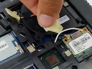

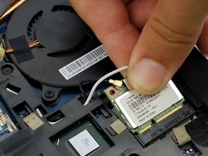

+[* black] Locate the WiFi card circled in the picture. Remove the top right screw from the WiFi card. Carefully remove the lower side of the tape so the wires have some wiggle room. Use the blue prying tool to lift the card and then gently pull on it to remove it from its socket.
