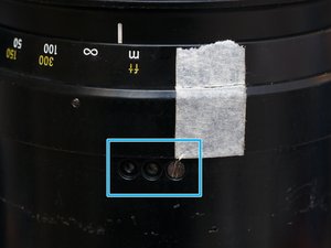

+[* yellow] Remove 2 focus stop screws. Your's might be in different holes. Also you may like to calibrate that. There 3 holes at the infinity end, and 2 at the close-up (8m / 25 ft) end.
