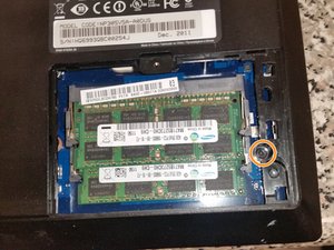

+[title] Remove memory door & screws
+[* red] Remove the single screw from the memory door, and pry the door up.
+[* orange] Remove the single screw under the memory door.
