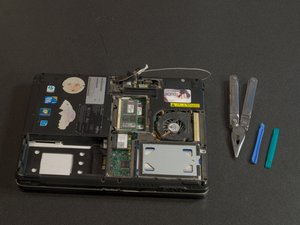

+[title] Disconnect the display cables
+[* red] Disconnect the wifi and bluetooth antennas. The gray wire is slightly longer and connects to the socket labeled with a "1". The black wire connects to the socket labeled "2". Notice the routing of the cables under the metal tabs so you can replace them correctly.
+[* orange] Disconnect the pen/touch cable. It is difficult to remove. Careful use of spudgers or small needle nosed pliers may be helpful in lifting it evenly.
+[* yellow] Disconnect the LVDS video cable. The LVDS connector has a pull-tab making it easy to disconnect.
