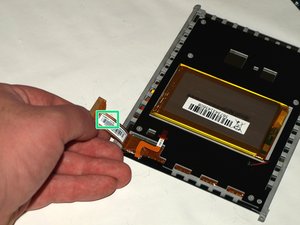

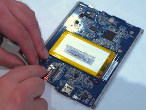

+[title] Disconnect the second display cable
+[* red] Gently open the second, smaller Zero Insertion Force connector by prying up the brown pressure-clip from the bottom.
+[* red] Slide the cable down to disconnect it.
+[* green] On the back of the display cable, you will find the full model number of your display, which you should use when searching for a replacement to ensure you get the correct part.
