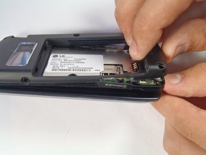

+[* black] Now, slide a spludger in between the two plastic pieces that form the outside of the back case
+[* black] Gently work the spludger around the edge of the case to separate the two pieces

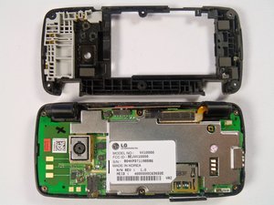

+[* black] Once the case has been separated you should be able to see the circuitry inside the phone
