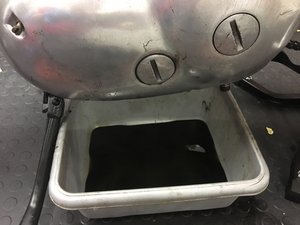

+[title] Remove the primary drive cover
+[* black] Remove the 7 screws holding the primary drive cover on.
+[* black] You can either drain the oil first, or just put a dish underneath to catch the oil spillage.
+[* black] Lift the cover away. Note that the cables to the alternator will still be attached, so make sure the cover is supported and not pulling on the cables.
