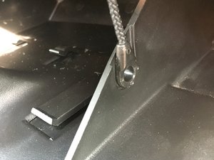

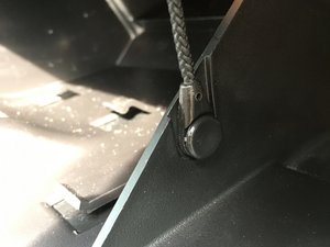

+[title] Right Glove Compartment Door Support Cable
+[* black] To remove the right-side cable, you must push the center pin out of the clip first.
+[* black] Now, the clip can be removed from the door. Just push it through the hole.
+[* black] The door should now be fully disconnected from the car.
