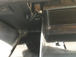

+[title] Left Glove Compartment Door Support Cable
+[* black] The left side supporting wire is pretty easy to remove.
+[* black] Pushing the clip down will allow you to slide it out of the door, releasing the cable.
+[* black] This cable is spring loaded, and will retract upwards into the dash.
