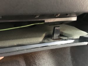

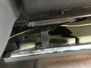

+[* black] Now remove the clips on each side. This can be done by pushing the exposed tab forward.
+[* black] The kick panel should now fall down.
+[* icon_caution] Don't pull the panel out just yet, there's still a courtesy light that is mounted on the panel and connected with a wire.
