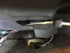

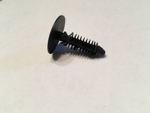

+[* black] Use a plastic fastener removal tool to pop out the plastic fastener. This fastener was not designed to be easily removable, but the tool helps a lot.
+[* black] If you're careful, you can remove the fastener without damaging it. Try to fold all of the "ridges" back before re-inserting it. If you plan on removing the kick panel again, you may want to invest in a fastener that's [https://www.amazon.com/OFFROADINGLIGHT-Retainer-Push-Style-Assortment-Chevrolet/dp/B06XG5JP3L/ref=sr_1_2?ie=UTF8&qid=1496018314&sr=8-2&keywords=plastic+fastener+assortment|easier to remove.]
