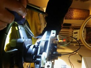

+[* black] So we will try to open some holes around the broken plastic, with the solder iron.The holes should be as big as for the zip ties can pass through them.Our aim is to tie the zip ties around and make the broken plastic strong again.
