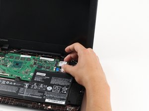

+[* black] Use a Philips screwdriver to remove the screw (4.3 mm head, 3.6mm length).
+[* black] Gently pull the wireless card to remove it from the motherboard.
