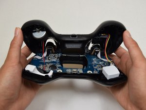

+[* icon_caution] Use the Magnetic Mat to prevent loss of screws
+[* icon_note] Total of 6 Screws are located in the back of the controller.
+[* black] Flip the Flypad over
+[* black] To remove the six screws, use screwdriver T6
+[* icon_note] Note: the bottom left and right are longer screws
