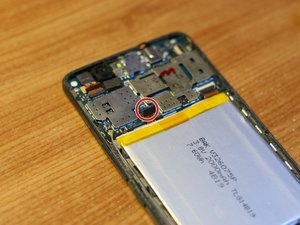

+[* black] Nice, I see you've got the cover off
+[* black] Disconnect the battery (not with a metal tool)

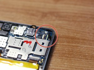

+[* black] Disconnect the touch screen ribbon (don't pull hard, you have to lift the plastic bit before)
