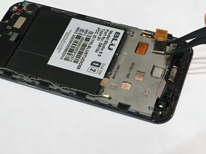

+[* black] After the motherboard has been removed you will see the back camera, which is glued to the phone assembly.
+[* black] Using a pair of tweezers grip onto the sides of the camera and gently pry it off the panel.
+[* icon_reminder] Make sure that when you put in the replacement it is adhered to the phone panel and the flex cable connector goes in through the motherboard opening.
