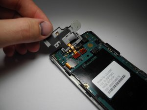

+[* black] Gently lift the corner of the sim card assembly as shown.
+[* icon_caution] Caution: A flex cable is located underneath the sim card assembly.
+[* black] Gently pull the sim card assembly toward the top of the phone. Locate and release the flex cable connector underneath by lifting it with a pry tool before fully removing the assembly.
